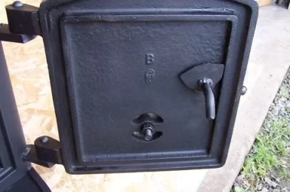

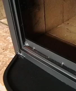

    Welcome to the forum,
    This topic was already discussed in the "Everything Fisher" thread. The doors were called "Triple Seal Cast Iron Door".
    Just curious if your Mama or Papa Bear had gasket material added to the door to make you wonder if the same design stove required a gasket. Perhaps someone added gasket material to your old stoves knowing other stoves required it to seal the door?
    It should have a piece of channel iron welded to the stove front, and the door has a raised cast iron edge that goes between the channel iron, this is a triple sealing contact area considered air tight without gasket material.
    Glass doors DO use gasket material providing a cushion for the door glass if closed abruptly.
    Glass option was not available on "Bear Series" Papa, Mama or Baby Bear. Glass was available on Fireplace Series, Insert , or Pedestal Stoves.
