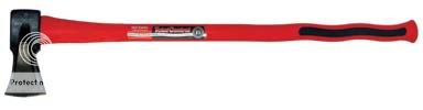

Does the 4lb "Super Splitter" from Lowes look like this? Made by Ames/True Temper?
[Hearth.com] fiskars coming!
I had one of these for years and didn't use it very much, especially after I got my Fiskars. The Fiskars taught me that a sharp edge and low friction can really increase performance so I decided to try to add these qualities to my True Temper. After putting a very sharp edge on it and sanding all of the paint off, it became very effective and now I use it quite often. I think it's got great head geometry it was just being held back by a dull edge and painted sides.
