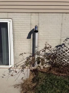

    We discovered that the smoke was coming from the pipe inside the wall where it connected to the exhaust cap. They made that connection inside the thimble so we couldn't see it until we took it apart today. There was soot all over the seams where the 2 pipe sections came together. It was either defective or wasn't snapped together properly.

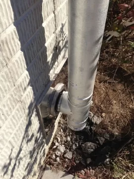

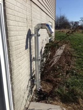

    All the old vent pipe was removed and replaced. Now coming from the back of the stove we have a 3" to 4" adapter, 12" pipe through the wall (I have a ridiculously thick basement wall), connected to a T, 4' vertical rise, 90 deg elbow, and the exhaust cap.
    The door was also adjusted to seal more tight and we double checked every vent pipe connection to make sure they were sealed.
    Now I'm just waiting for the silicone to cure so I can start burning!

    I hate to rain on your parade, but you still have a joint in the thimble. You need to be able to visually inspect every seam that could leak carbon monoxide into your house. It might be good today, but leak tomorrow, or next year. A kid could bounce a soccer ball off the pipe, you could back your lawn tractor into it. A thousand things could happen that can break the seal.

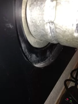

    I'm in an odd position because I have 12" inch thick walls and those exterior brackets require the vent pipe to be a certain distance from the wall which limits what I can do.
    I've attached a picture of where the stove adapter meets the interior thimble. Should I seal that gap with thermal tape or some silicone?

    The vent should have a longer horizontal piece. I dont know if they make an 18" , but a 24" would still be acceptable for 4" venting. Making sure to keep the 1/4" rise per foot.
    Glad you got the 4" and got that vent out of the weeds.

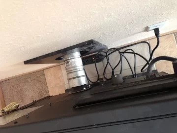

    No doubt. I looked right at the wall outlet.
    But now, looking at that "Strip", I would still question the maker? Joules rating? ? And clamping speed?
    Most strips are junk. Most... Not all. His may be a good model. But $9 unit from Wally World is about as much help as cord wood is for a pellet stove ;)
    One last thing. The Damper setting? Looks as if its almost closed (all the way)? That would explain the Black.on your term cap and on the ground (where is exhaust hit).
    Open the damper a little. You want a very active and lively flame. Not a slow, lazy, and black burn.

    The power strip is a GE branded strip rated for more joules than the stove can handle. Computers are my RL business and hobby so I know the value of good electronic protection. ;)
    I opened the damper quite a bit before I burned it last night and slowly closed it until I got to the sweet spot. Burned it for 5 hours and got no black on the glass or firebrick which was a first. It was only a grey film in one spot so I'm thinking I might have the airflow right. I wish I could clean some of that crap off the firebrick from before but that's another story.
    I used a flashlight to look for leaks on startup and did notice a small puff of smoke from the adapter still so I'm going to wrap that connection with some 3M flue tape rated for 600 degrees. Hopefully that will catch what I missed with the caulk.
    Does anyone have any advice for that gap on the interior wall thimble? Should that gap around the vent pipe be sealed with caulk like it is on the outside?

    There isn't supposed to be any sealant around the vent on the inside surface of the thimble.
