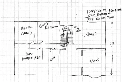

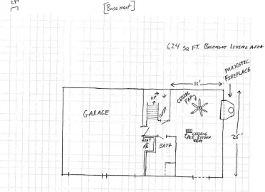

First of all I must say that I have been looking forward to posting this topic for several weeks now. Hearth.com has been a huge help to us over the last few months as me and my wife have been planning our wood-burning future! :cheese:
As you can see the current fireplace & hearth is located in the basement of our split level house from 1979. It is a Majestic zero clearance fireplace (built 30 years ago) and is located on the eastern wall of our home. We considered going with an insert and running a ss liner down the air-cooled, prefab metal chimney. However, there were very few inserts that both qualified for a ZC install and that would fit in the somewhat small fireplace (only 21" tall). BTW the insert in the picture below has been removed - it did not meet codes and was improperly installed in our system.
The current plan:
Jotul OSLO or comparable freestanding stove product.
Place stove in front of fireplace opening - this requires knocking out the three layers of brick hearth and putting ceramic tile down in this area
A rear venting stove could be up to 30" tall and still fit
Run a s.s. liner in the chimney meeting UL1777 standards
Connect to a T inside the metal housed fireplace
My concerns at this point:
Will this setup provide sufficient heat to the entire living space of nearly 2,000 sq. ft.?
Will the basement become unbearably hot?
Would running the aux. fan on our furnace/ ceiling fans provide enough air movement through the home to help the spots farthest away from the stove stay warm?
Are there other stoves that would be better?
A few additional notes:
The basement is finished with insulated walls except for the garage and the door is always closed between the basement and garage.
Attic is well insulated for Missouri at R35+
See diagrams for additional information.
Please help us out with any comments/experience/questions.
Thanks in advance.
