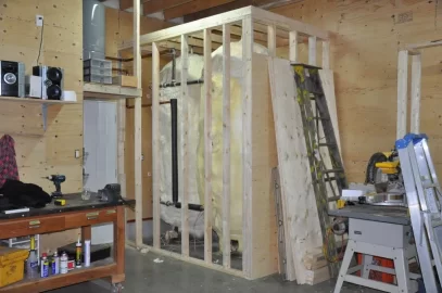

Just need something to put around sensor wells and valves so I can have easy access

Good looking work Huff. Are you putting more insulation around them? Or just covering them up to make the place look pertty? Going to look good. Are you going to miss the fossil fuel bills? What was yours again? Propane? What kind of shape are you in for your wood supply for next year?
Looking really good Huff. Now comes the payoff both financially and confidence in what you have accomplished.
Well Done!
Looks good. A few hinged access doors? or removable panels fixed with screws?
How about some large PVC pipe sleeves? A short section of 6" sewer pipe extending from tank to outside box would work. Put a piece of Fiberglass insulation in it that you can pull out. You could also put a cap on it if you want to get fancy.
Valves you would need some bigger pvc.
gg
Thanx All ! I will be filling with cellulose or fiberglass not sure yet. When the tanks are hot you can still feel heat coming of them,but I think most of it is coming from the uninsulated pipes up there. I will try forming thin plywood to the tanks where the accesses will be . then spraying foam along the back edges where it meets the tanks to keep the insulation from falling into the access holes.

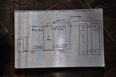

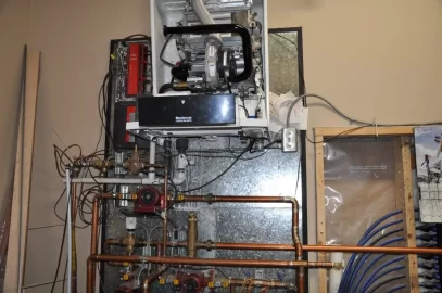

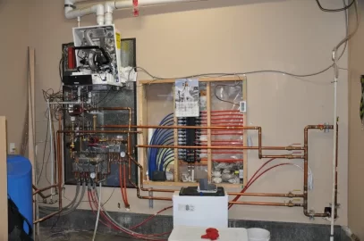

Here are some pics. of teeing in my house loads to the house loads loop. And the deactivation of my lpg. boiler :lol:

I think I am going to be taking out my Primary Secondary manifold this year and putting in a buffer tank/Hydraulic Separator closer to my load. I think it would keep hot water closer to my heat loads for better response.
gg
One thing I will be changing with the buffer tank in the future is the position of the supply for the shop infloor heating I think I should of drawn from the bottom and returned the bottom . Water is always hot enough down there anyways . Right now the supply is on the top third of the tank and the return s on the bottom.
HD

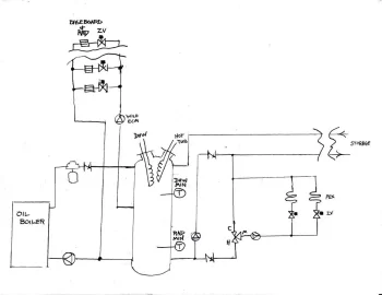

huffdawg said:
One thing I will be changing with the buffer tank in the future is the position of the supply for the shop infloor heating. I think I should of drawn from the bottom and returned the bottom . Water is always hot enough down there anyways . Right now the supply is on the top third of the tank and the return s on the bottom.
Except that water at the bottom of the buffer won't necessarily stay hot enough for long if low temperature loads return to the bottom of the buffer. If high temperature load activity happens to provide the necessary net flow to storage it would work fine, but only by luck.
What I came up with was to pull low temperature loads from the bottom of the buffer/hydronic separator and return to storage by connecting on either side of a check valve.
This results in a net flow from storage to the top of the buffer tank, where the high temperature loads get a shot at it.
I believe this guarantees that the low temperature loads will always get the lowest useful temperature water available, but at the same time it also guarantees that the low temperature loads will always get the heat they need independently of what the high temperature loads are doing.
