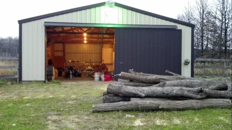

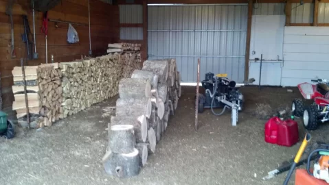

    Depending on how much you do, it can be pretty cheap to start new. I have a 30 x 40 (no slab) that was bought and built for about 12k. They did it in about a day and I built walls (and stalls for horses, but have since tore the stalls back out).
    If I had it to do again, it would be to go bigger and put closer to the house (100 yards away).

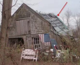

    I would think twice about a metal building. My friend had a metal shed for his motorcycle. He had to get rid of it because the dampness was rusting out his bike. He got a wooden shed and now has no moisture problems!!
    Also where are the pics of your existing garage for our comments?

    Hi Begreen
    I really do not think there was any insulation. That is why there was condensation and sweating!
    So do you have some pics?
    Does it look like this garage?
    Click to enlarge and see Red arrow

    Ha! LOL The building is standing and although funky, it's lines are true.

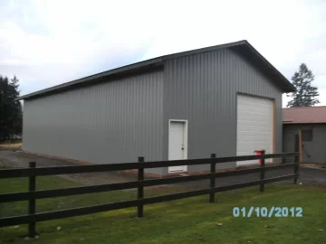

    I am just finishing up a 30x60' polebarn garage building. I had three bids and they were well into the 40s and 50s to finish what I have built for abut 25000$.
    I chose pole construction for cost and then used a normal composition 4:12 roof with 2 foot overhangs to match the house. Since I built it I know it was done right and had chances to do special things like renegade plumbing into the slab. Insulate the slab and put in 1800 LF of pex floor heating pipes, more and better rebar, proper fasteners, etc.
    The companies can fling a building up quickly but their assembly line procedures ensure a barely code compliant build. I wanted better than barely code compliant.
    I tore down a 12 x20' old barn from 1963 and now have a slab for washing cars. The old barn had roof sheathing with concrete stains on them. They were the old form boards for the house!
    There is no reason at all that a building has to be torn down to pour concrete inside. I have done two large indoor pours in my home as part of remodels and the guys just use a line pump to bring the mud in. Actually kind of nice since the lighting is overhead and the weather controlled.
