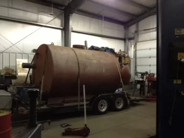

    i bought an old garn that needs a little work. i believe its a whs 2500, mid 80's. it looks different then the new ones but its a garn. looking for input for any improvements that i can make as i overhaul it before i put it in service.

    Does it have the air nozzle in the middle of the loading door? That would make it mid-late 80's.
    There's really not a lot to go wrong with a Garn but you could start here......
    1. If it's been sitting around for a while it might be wise to give it a good power wash inside the tank to check for any pitting or scale.
    2. pop off the flue tube cleanout covers and have a look. Get them cleaned up if they need it.
    3. Check the door gasket and door adjustment
    4. If I were you I probably just go ahead and replace the wind up timer and the relay in the control box.
    5. Check the low water float switch to make sure it functions and will not let the motor come on if the water level is low.
    6. Pull the motor and check the blower wheel to see if it is distorted. They are made to purposely fail under extreme conditions to snuff out a runaway condition and i have seen a couple that have done what they were supposed to do. (They come apart at flue temps over 1000*F)
    7. If the inside was dirty or it had been sitting for a while, I'd probably get in touch with the factory and order up their pre clean and chem treatment program. Send in a sample of your fill water and have "Chemical Mike" at Precision Water Treatment do a workup for you. (included in the treatment program) After you get it cleaned and flushed out, add the chem treatment they provide and let 'er rip!
    I really don't know how long one of those things will last given decent water chemistry and maintenance. I have personally serviced several dating from the early 80's. Pushing 30 years old.
    Good luck with your project!
    You can still get most parts for it here. http://shop.garn.com/

    Cool. How did you come across a used Garn? And do you have a pic? What kind of shape is it in?

    the bottom of the tank is soft. leaked from the outside in. so im replacing the bottom of the tank. when i have it opened up im going to clean it up. it has the control box that has sensors at the top of the tank, bottom exhaust and outside, but no low water sensor.

    pretty good shape. found it on craigslist in MN. 3000 miles later.

    heaterman, it does have the air nozzle in the middle of the door. i was wondering if thats a downfall?

    That's early to mid 80's vintage. The major issue with that style is that the door or parts for it are no longer available, at least as far as I know. You can get the tadpole gaskets.
    The "draft box" on top of the door on those old beasties is usually found to be out of commission. It had a damper in it that diverted most of the airflow to either the nozzle in the center of the door or to all the holes along the outer perimeter of it. The assumption was that the user would allow the fire to get going with the air diverted to the nozzle in the middle of the door at the start of the fire and then move the damper to the secondary position after things got cooking. Worked good if actually used that way but most users just neglected it and the damper wound up becoming non functional because they were never moved. I would bet yours will be in that condition also.
    I know a couple guys that cut out the bottom of the tank and welded in a new sheet. It's just regular mild steel......seems like it was 1/4" material. Both are still using them.
    Here's the parts that you can get yet for it. http://shop.garn.com/garn-model-2500-1985-1988/
    The actual model/serial number were on an adhesive backed aluminum tag located on the inner surface of the blower mounting area. We ran across serial number 29 and 44 last year and got both of them up and running for a guy on a dairy farm up here. They were both 1500's. We had to get a new inner door ring fabbed up by a local metal shop but other than that they were good to go.

    i was checking out the draft box last night. it does move but not all the way. pretty sure its saveable. as for the serial number i cant find it. the tag is there but no serial number. id like to find it just to know what it is.im guessing its a 2500 just because of its size. as for putting it in service im going to wait until next year. one more year with the seton
