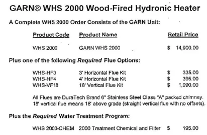

what is the price range on a garn..just approximate...they are big!
barkeater
This is a quote from a dealer 2008.
