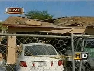

ECO (energy cutout), is built into the valve. 190 °F is pretty darn hot for any glass lined tank, most manufacturers recommend 180 °F max. on glass lined storage, indirect and solar tanks.
You also have, or should have a 210 °F T&P valve in the tank. If it pops be sure it is piped to a floor drain or you could have some serious water damage.
If the ECO at the bottom of the tank hit 190 °F the top where the relief is located could be much hotter, dangerously close to that 210 °F That relief valve is also a one time on temperature release.
That is why it is important that the probe of the relief valve be in the top 6" of the tank, top or side. Never move it out on a tee without an extended probe.
Might be a good idea to check the function of that relief valve, they do stick from time to time. An overheated tank without an operating pressure relief valve can make for a BIG boom. A new T&P is probably under 20 bucks, very cheap insurance.
Look into piping a bypass or some sort of high temperature protection mechanism.

Thanks for your safety tips and advice, hotrod. It's something DIY enthusiasts tend to forget/ignore from time to time, and it's always good to get a reality check from a pro with experience. Heck, at first I thought those pics were from Haiti.

Yet I have seen all of them fail and the tank foes towards the moon. Watts has some good video of this on their website also.
