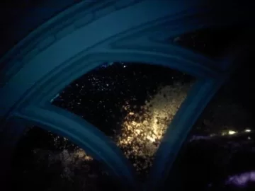

    here is a pic of what it looks like.

    Wet wood issue....my thought!

    Yech! That doesn't look right at all!
    Did you say your wood is kiln dried (KD)? Hmmm... I'd swear that black was from wet wood.

    Given what you've shown us on the windows, you've also got a lot of nasty crap deposited in the flue, and really need to change tactics.
    Near-term I'd plan on a series of hot, clean fires to loosen up the flue deposits, encourage them to drop, and make it easier to clean the flue soon.
    Whenever you're trying out a particular tactic, you don't need to wait until morn to evaluate it, just go outside and look at what's coming out of the chimney.
    You may need a flashlight to see what's happening up there; it's important to look now. Any smoke is BAD; do what you've got to do to clear it up.

    Some good advice has been given. I'll second the way to clean that glass is dampen a newspaper, dip it in the ashes and wipe the window clean. A very simple, cheap and easy solution to that problem. But what about preventing that problem? Of course you can use other cleaners. Even after the cleaning with newspaper and ash, you can finish the job with windex and paper towel too.
    Naturally the wood is suspect. You state kiln dried and debarked, but was it also split? What kind of wood is it? If it was kiln dried (but to what moisture content?) there is no way that glass should get black.
    On getting the stove ready for the overnight burn, I do hope you are letting the fire get good and established before turning the draft down. Most often folks have the best results with dialing the draft down in stages. For example, if you dial it down to maybe 1/4 open, then it is full open on the loading of the stove. After the fire gets going good and the wood becomes charred, you might dial down to 1/2. Then after maybe 15 minutes or so, dial it down to your normal night setting.
    When you arise in the morning, if your stove temperature is 200-300 degrees, you should smile. That is good. Now you just run the rake through the coals and put some wood in it and all is fine.
    With the glass being black, that also signals you to keep a close watch on that chimney. Check it monthly at least. Clean it if it is dirty.

    To me that looks like wet wood. On my stove i can close air down and run at 400 to 450 stove top and not get dirty glass just some very light haze.

    I also would question the wood.
    But I also think that you could be choking it down too soon too. Is the Kiln Dry store bought? Like "Hot Sticks". Usually good dry wood has a feel and sound to it. Kiln Dry wood is obvious when burned. The stuff takes off better then pallets or wood scraps. There shouldn't be any black with Kiln Dry - the fire would burn very hot and the glass should be clean.

    70% of the time . . . black glass = wood isn't seasoned enough.
    42.4% of the time . . . person has cut off the air too soon and smothered the fire.
    33 1/2 % of the time . . . person has not got the stove hot enough and has cut back on the air.
    12% of the time . . . split or round has rolled up in front of the glass blocking the air wash and allowing the glass to go black.
    10% of the time . . . bad gasket.
