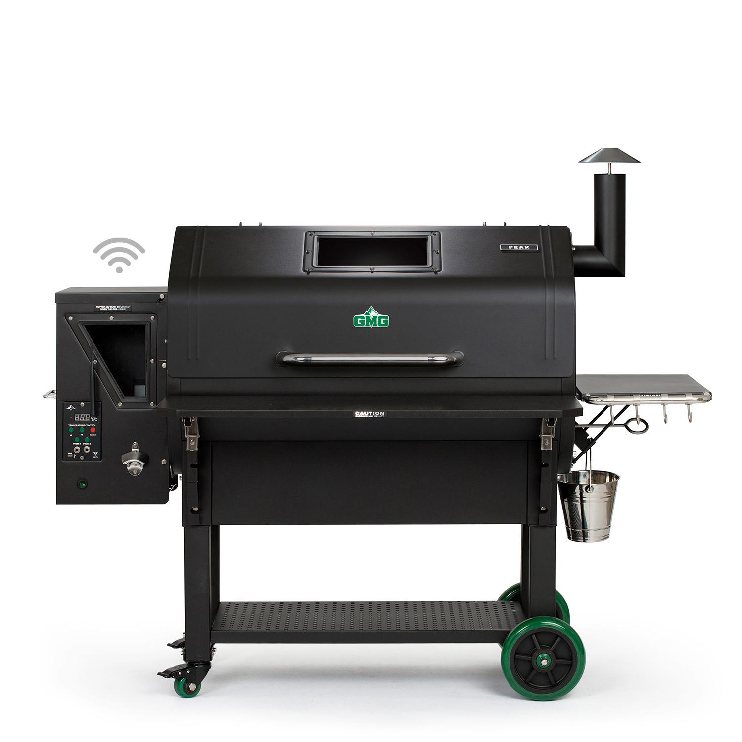

The new GMG peak pellet grill is 212 lbs so it is definitely a heavy weight. Also it is used in many grill competitions. :-)
I think WiFi is a must but that is just me.

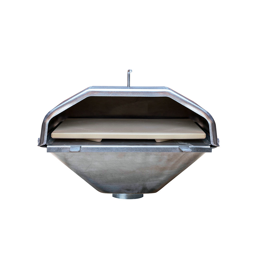

Also if you want amazing pizzas in 3 mins flat then check out their pizza attachment with the pizza stone!

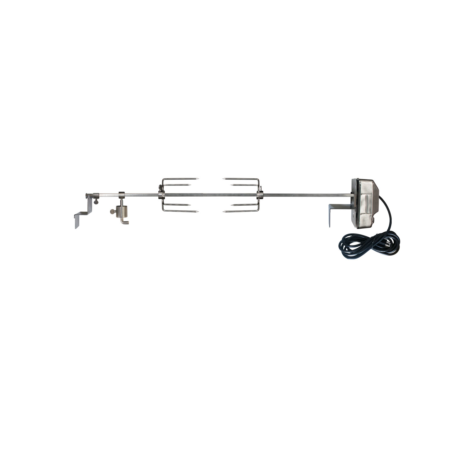

Also check out the rotisserie!
