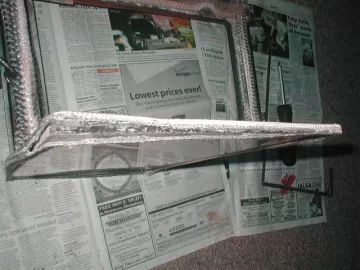

Ok, as I suspected I would be, I was more "get it completed" than worried about photos. I took some, so here they are.
Pulled the glass out and the gasket was cut at the edge of the glass.

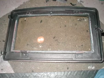

And here is door inner with glass removed.

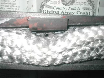

At first, I was going to leave the gasket on and work around it. Here is a shot of the retaining screw removed from one of the framing clamps. I was able to move the door gasket back enough to get to the screw.

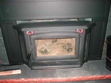

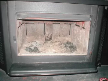

The other photos is of the insert without the door on. I wanted to get it on and closed up while I waited for the new glass. I took the old glass out so I could get an accurate measurement. They manual is incorrect and had I gotten the size the manual specifies, it would have been too large and not fit.

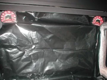

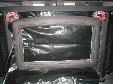

I hacked off a pc of 6mil black plastic and used the two thermometers I use on the insert to hold the plastic in place while I set the door back on and closed it over the plastic to seal it off until the new glass arrived.

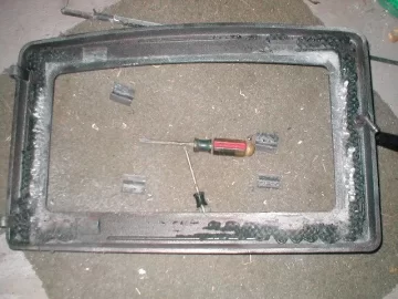

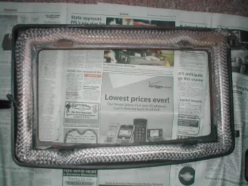

Pulled the massive jumbo 1" gasket I installed last year on the door, and had to clean the silicone off. A wire wheel and scraper works real good. Scrap the heavy off, I used a 1" spackle blade & razor blade, then wire wheeled i7 spanking clean. Then put the new glass with new glass gasket & retaining frame in place. Not clamped and screwed at this point.

I then set the 4 clamps, and put seizing prohibitor on the 4 screws. And slowly and a lil each time tightened the screws on the clamps, which in turn clamped down on the framing. One thing my ol man taught me when I was young, was to tighten bolts/screws etc a lil at a time and criss cross or alternate the tightening sequence. Similar to engine head bolt tightening patterns etc. I did the same with the glass, just knowing it was going to crack the next tightening round. Tom told me they would bottom out before breaking the glass, but I was still worried not wanting to break or crack the new glass. Then I got paranoid it was not tight enough and would leak air.
So I slowly alternately tightened until they all pretty much stopped. And it didn't break!!!!!!!! Or crack!!!!!!! UG UGG UGG!!!!!!
Next I pumped a bead of silicone on the door getting it ready for the door gasket. I opted for the factory high density 7/8 semi flat gasket this time. Set it in place, and put the door on the insert. Checked that the gasket was centered on the knife edge as best as could be. Of course the latch needed tightening now with the thinner gasket. I am still not sold on this gasket. I have it almost close to max adjustment for tightening, and the bill is fairly loose on the latch side. If it won't seal, I'll rip it off and go back to the 1" less low density round gasket like before. I KNOW that seals well.

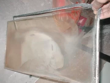

And lastly, the old glass, now kept for emergency back up.
