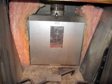

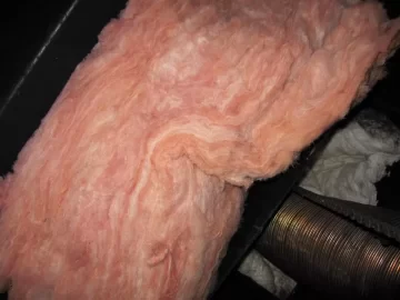

Will the insulation 6" fiberglass create more heat.than losing it to the side walls of the fireplace? The other photo is of the flue closed off by a block off plate which is above the fiberglass. The white is stove insulation on the flex pipe side.
Only one photo made it. Is this a double-sided fireplace? If yes, I don't think I would insulate at all. A damper block-off plate should be sufficient.
+1. Any brick that warms up is just going to release heat to the rooms anyway. I wouldn't have insulation stuffed right up against the unit regardless.
Thanks for the advice. I will remove the insulation on the sides of the stove. It has to heat more of the brick surrounding the fireplace, and through it into the house.
You might want to put a nice expanded or stamped metal grillework on the backside for a cleaner look. That will let heat from the back of the insert into the living space.
