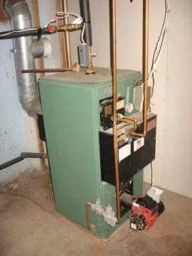

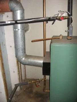

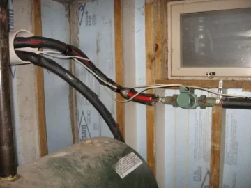

Perhaps this will help someone diagnose the problem. I have the thermostat turned up, but the radiators are not getting hot. There's also making a soft noise (almost sounds like a car trying to turn over, but on a much quieter scale).
I can feel hot water coming in from the stove to my oil furnace, but it doesn't seem like it is being circulated through the house.
I have had this happen to me. The knocking is steam and air like the others have already said. This happens because water is not circulating and same problem with the rads. Like 2beans said, you have air in the system and the circ pumps aren't working because they are not primed. You need to purge everything, if you don't know how ask your heating tech.. If you have a regular air purger in the system you may want to change it to a spirovent, they are better at getting all the air out. But even they can't do it all. Maybe your system needs a few design tweaks, or maybe just a good purging. Also, check to make sure all circ pumps are working, they do burn out their motors now and again...

Hi everyone. You will be happy to know that I did NOT blow up. Unfortunately, the air that got into the pipes has caused quite a disturbance and we've spent the last three days working with the previous owner (the builder) to replace valves, bleed pipes, etc. etc. As of now, things seem to be running smoothly. The wood stove is back in operation, and the temp has been running at a normal level. Many thanks for all of your input, especially to 2.beans. It was greatly appreciated.

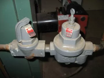

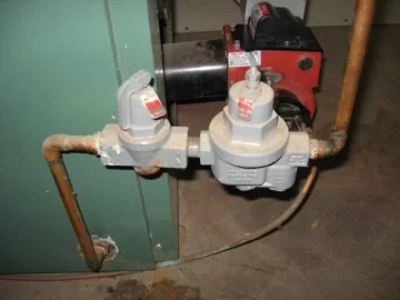

Not a plumber, but aren't those both regulators?
What fills the system and keeps it full? Should be a auto fill
regulator w/ a back flow preventer coming from the
domestic supply. Got them?

For those of you wondering about the back-flow preventer, I did ask about this. I do have one, although I'm not sure where.
