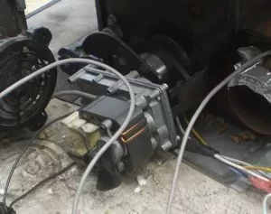

Take the gear motor (auger motor) off the auger.If the auger turns, its the gear motor. If not,remove the two bolts that hold the auger in. Work it back and forth while pulling it out. I had a flange bolt locked up in mine that kept the auger from turning. I was sooooo surprised it was even trying to feed the bolt without burning something up. While I had mine out, I wire wheeled all the build up off the auger. Works fine now.HTHS
  • [Hearth.com] Harman Accentra Auger not rotating

Just wanted to update everyone... I took the motor out and there was a nice big 3" screw preventing the auger from spinning. The motor itself had died and I put a new one in and everything is working perfectly now.. Watch out for what goes in the hopper. I have no idea how the screw got in there..
