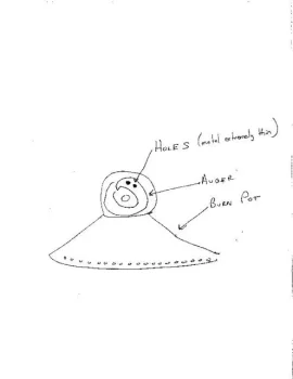

In the meantime, here is a very crude diagram of what I am talking about.

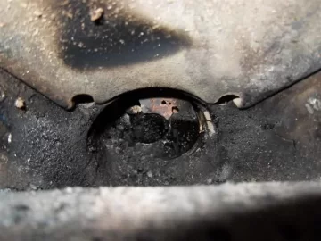

I cleaned the stove, and did a quick shutdown to take photos after it had only been burning for a little while after the cleaning. I didn't clean the burnpot as well as I would have liked for the photos, but hopefully they show what I am talking about.

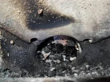

The other photo. This was taken before I removed some of the ash and partially burned pellets.

Just some background. The stove was purchased new in the spring of 2008, and was manufactured at the same time. The stove is professionaly maintaned and is regularly cleaned by me. These photos make it look a little worse, since I didn't clean before taking the photo. I opened the stove when the fire was still smoldering, which may be why it looks much more black than normal.
The stove is currently working fine, although I'm starting to think I'm on borrowed time.
Wow, I don't think they are supposed to be there!
Quick look is that somehow it overheated - that orange color usually means that.
That does not mean you did anything, but that maybe the spec on the metal (auger) was off or air is coming in at the wrong places, etc.

Damn, that looks like metal failure.
I can count four holes and the start of at least three more.
I've emailed the dealer, and attached a photo. I'll let you know what happens.
metal failure due to overheating......but still warranteeable.......have the dealer replace the auger....easy and fast, maybe half an hour job, and that includes drinking coffee......havent seen one like this though....thats an old-style auger, by the way......even less prone to erosion than the newer ones, no need to worry, but it should get replaced....
Do you have the five holes at the bottom of the burn pot? It may be because of it burning in the auger tube, seems to be an issue with Harman stove sold in 2007 - 2008. They should replace the burn pot if it does have the five holes.
I totally agree with swalz. By the looks of the auger tube there is way to much carbon buildup within the auger. I would check to see if you have the lower holes in the burnpot that would indicate this issue could of been caused by the poor design of the burn pot for the few years they were released. I think all of the Harman owners here are very interested on how the dealer and Harman will handle this issue. So keep us informed and thanks for going through the trouble to get the pics posted. A picture says a lot!
