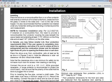

If the P61A is installed 'kitty corner', what is the clearance that is required at the back of the stove (hopper corners) from the 2 walls ?
I'm looking at getting this stove, hence the question.
I believe Fig. 3 is what you are looking for.
  • [Hearth.com] Harman owners of the P61A --- Question.. ?
From the back corner of the hopper straight to the wall is 8". [Hearth.com] Harman owners of the P61A --- Question.. ?
From the back corner of the hopper straight to the wall is 8". View attachment 122610
Actually if you look a little closer the measurement is taken from the front side of hopper at the back of the burn chamber. The stove in the diagram appears to be touching the wall at the back corners of the hopper. I would want it out in the room far enough to get behind it for servicing.
In the diagram it is touching and that's to close.
