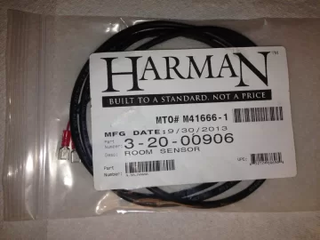

The old P61a just did not seemed to be regular. LOL I mean regulating! LOL
I upgraded the control board to the new dip switch control board. The newer algorythms in the firmware certainly helped. However it still did not seem all better!

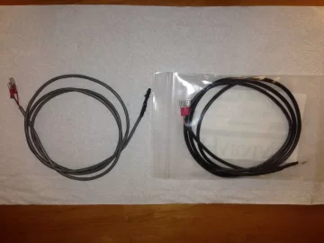

Then I upgraded the old gray room probe to the new black room probe and Bingo! The temp on the dial and the room thermometer are spot on!
Has anyone seen this issue?
Pic1 - Old gray and new black room probe
Pic2 - New black room probe

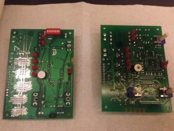

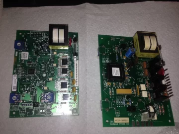

See board pics
New dip switch circuit board is on the left in both pics below.

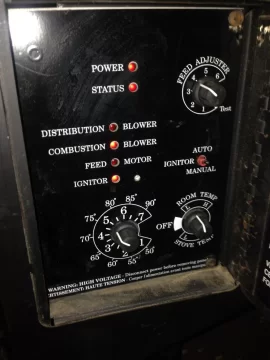

I just did the opposite. Turned the Temp dial from 80 to a notch under 75. The room wall Thermometer read 80 and the stove shutdown! Then I opened the garage door and the stove started to fire up!
Does 6 degrees difference between the room temp and the dial setting trigger a shutdown?
There must be some criteria here?

P38X2s comment is correct. The room temp probe is an approximate sensor. It may or may not match your room thermometer. My P43 is running in room temp mode set at 65 degrees. That's the setting that brings my room thermometer to 72 degrees. The stove cycles on and off as needed to keep the temperature right at 72. The dial on the control board is more for a reference when setting not an exact reading.
Ron
Ron
Exactly...the stove dial isn't anywhere near as accurate as a stat would be. I have at least a 5 degree difference in mine. Just compensate for it......
