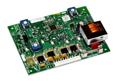

It's a common problem. The potentiometers (pots) get dirty and develop dead spots. Shutdown and unplug the stove and spray the knobs with DeOxit. If that doesn't fix it you'll need to replace the pots if you can solder in new ones or replace the entire board.

You need to unplug the stove and remove the board, then pull the knobs off....then spray behind the knobs

You'll see the 3 potentiometers on the back side of the board, use the spray , turn knobs back and forth, follow directions on the can..

My P68 is a 2008 model and there is no "off" detent that can be felt for the knob to rest in......just a white band that indicates off. Is there supposed to be a noticeable "off" detent? I wonder if early models circuit cards didnt have a built in detent......or if mine is completely worn out.
I have a 2008 Acentra insert, my old control board, which I replaced, did not have the "off" detent. My new control board does. My insert refused to shut down, replaced the ESP and the control board, all is well now.

I went from a red ESP to a black ESP on my Accentra insert when I updated the control board. The data sheet settings for the dip switches, that came with board, will tell you which switches to set on or off for which color ESP.
i have had this problem and about every other unrelated one you can think of and in the end it is dirty pots. i have gotten into the habit of turning the knobs on the pots back and forth several times a week. this has cured every problem that has come along. i also used the spray cleaner.
