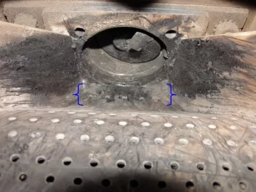

Well my XXV has the extra 5 holes. I am contemplating wheather I should do something about it or leave it be. Mine doesn't have any damage as of yet, but I don't want any either. I imagine the burn pot comes right off with 4 nuts and disconnecting the igniter, then it could be welded. One other thought I had was to tap the holes and put some short set screws in the holes and run them down flush. Also we have tapered pins at work for repairing cracks in diesel cylinder heads, I may check those out too. Anyone else going to do anything with theirs or do we wait till it fails then call the dealer since I have 4 years left on the warranty.................... I bet plugging or welding those holes will solve my problem of pellets burning in the auger tube about an inch in, since there wouldn't be enough air for them to burn in the tube...........
  • [Hearth.com] Harman Stove Defect
That burn pot is a lot different than the one in my P-38.
Mine has only 4 rows of holes , no holes at the bottom , and no holes on each side of the auger tube at 10 and 2 oclock.
I'm not sure I understand the problem. I have a P61A and my burnpot looks almost exactly like that one, with the 4 or 5 holes right in front of the auger tube. So what problem does this cause? Thanks!
I had my Harman XXV delivered in December 2008. Do you know if that means it was manufactured in the problem time frame you are talking about? Also, is it a design flaw in all the model XXV manufactured then or a manufacturing flaw that shows up in some and maybe not others?
My stove has been great (although we do hear occasionally a loud squealing noise.) What exactly should I watch for, besides that noise?
The squealing noise could be carbon build up that needs to be scraped out, or could be a problem with the auger, etc. Most common cause for squealing in the carbon buildup, once the stove is clean & still squealing then it's time to investigate the other causes. If you look at the right side of your stove, on the tag where the serial number is, near the bottom of the tag it shows the build date, years first, then months. If your stove was delivered December 2008 then it could be included in this time frame. It's a design flaw in all Harman pellet stoves, not just the XXV. Look at the photos above, you'll see what looks like a fine crack near the end of the auger tube, this is what Harman is repairing but not until it has actually failed (cracked).
