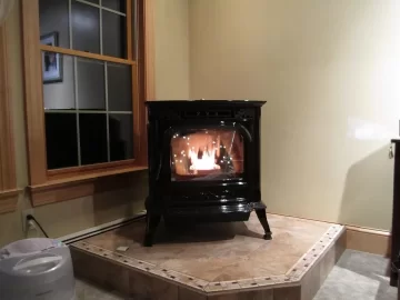

Here is a pic of the stove. I ended up making the stove board with 2"x6"'s and covered with ceramic tile.

the crunch sound is the slide plate breaking the long pellets (thats what my dealer told me anyway).........very nice install, enjoy!
