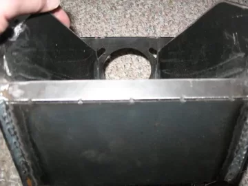

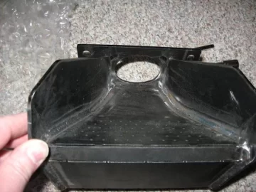

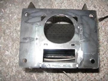

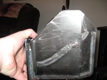

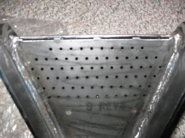

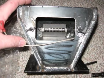

There have been issues with woofing, fluttering, and strobe like flames from some Harman pellet stoves. Some stoves do it and some don't. I called my dealer last week as the problem was getting worse. They called Harman and discovered that Harman is in the designing phase of a new burnpot to help with this issue. All right, the big day is tomorrow! I couldn’t wait to see the new burnpot so I drove to my dealer today to look at it. Here are some details:
1. Bigger, deeper burnpot.
2. Ignitor location is different.
3. Ignitor is the same but ignitor cradle is different.
4. More airflow through burnpot.
5. Flame guide is the same.
6. Harman still in the design phase of this burnpot, so I will be getting a hand-made prototype. (hope that’s a good thing)
Pictures to follow as soon as everything is switched around.
