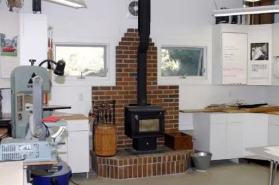

This certainly aint the cheapest of suggestions, but it's what I did in my workshop. Don't feel much like bending down to load/tend the stove. Nothing combustible beneath the stove, so it's kind of a no-brainer, you can do about anything you want, including nothing but cutting away the carpet the required amount all the way around. Gotta worry about all the other clearances, though. Rick

The cheapest, sit it on the bare concrete. If you want to build it up, don't use any combustible materials. If you want a raised hearth, use blocks to bring up the height, cover with a backer board and then tile. Make note of what Rick said, pay attention to your clearances and if you raise your hearth, less bending for loading.
