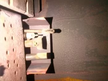

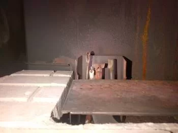

    Update.. I was able to remove the trim ring, as well as the glass front on my fireplace. I followed all procedures and was able to get my pilot to light. Problem now is that it will not stay lit, when I release the pilot from being pushed in I hear the gas just stop running and the flame goes out.. Upon investigation I believe I may have a bad thermocouple. I am trying to add the pictures but it keeps telling me the file is too large. At the end of the thermocouple it is split and spread open. I will try to re-size my pictures to upload them.

    Here are pictures.

    That may have been a DSI unit at one time, but now it's a standing pilot unit, & the thermocouple (TC) is Definitely shot... You may have to get the serial number off the valve in order to get the correct TC,
    but if you remove it & go to an industrial heating supply place, they may be able to match the thread for you.
