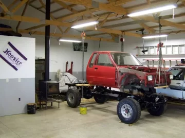

    I have a 36 x 40 X 10 pole barn with r15 walls, r5 roof (I know I need more...planned), open rafters, with a concrete floor. I have a NC30, with blower & ceiling fan, in there to take the chill off. I find it easy to get the room temp to 55 from the mid 30's in few hours. I don't heat it full time, only when I'm working on a project. It's never been below 32 in there.....I make sure of that firing up the stove every now & then when the outdoor temps get into the teens. The concrete floor is a BIG heat sink, thus it takes a while to warm up, then again a while to cool off.
    What you're proposing is very doable. The floor ( heat sink ) is what you'll be battling most. If you start early & stay ahead you'll be ok....it takes a while playing catch up if you're shooting for the 60 - 70 deg range. A large, non cat stove, with blower, will be needed. 2 ceiling fans will assist in air movement. Another suggestion...check into an epa wood furnace.
    Here's an interior pic...no fire in stove
