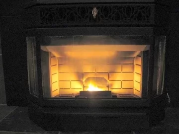

    Looking at the size of the flame on level 4, I probably understated in the original post. It goes to pretty much to the top of the fire brick. I have my draft setting almost closed. On level 4-5 I have it open a little more than 1/8", on level 3 I run the draft just a hair from completely closed. My house is probably max hieght of 25' outside. I wonder myself if the cathedral ceiling is what's killing me. I know it's not livable space, but the stove needs to heat it nonetheless. Where would I find the sizing info for my electric heaters? Upstairs in the loft tends to run about 3-4* warmer than downstairs. The ceiling fan does a pretty good job of keeping it fairly close in temp.
    I used a meat thermometer on the top of the heat exchangers were the air blows out. On level 3 with the draft just about closed I get 178- 180*. Granted this is probably not the most accurate way to check the temp, but it's probably in the ballpark. Could I be loosing heat up the chimney somehow? Does 178- 180 sound consistent to what the stove should throw on level 3? I can't get an accurate temp om level 4 or 5. The thermometer only goes to 190 and level 4 is above that. Tomorrow I will try to post pics on the house and the flames on different levels. It's always easier to be able to see!!! Thanks for the help guys.

    I had a chance to look at my freinds St Croix Afton Bay. From what I understand it’s basically the same stove as my York only in a freestanding version. It has the BTU rating and sq ft rating. His flames are MUCH bigger flame than mine and the blower is also more powerful. His level 1 flame is about as big as my 3-4, also a lot more heat. I read another post on this site where a York had very small flames, wound up being a defect. I tried attaching pics with the stove on all 5 heat levels. Far left is level 1, far right is level 5. Hopefully I'll do this right. Do these flames look consistent to other York owners? Thanks!

    Your flame should be huge on setting four or above....how is your damper set? Btw..all St croix pellet stoves are virtually identical ....

    The damper is set about a pencil's width from closed. I really think something is wrong w/ the stove after seeing my freinds. A lot of times on level 1 you don't even seem the flame get above the burn pot, it's just glowing. This could explain why this thing is incapable heating such a small house. Today was 34 outside, I had it on level 4 all day, when I got home from work it was 65 inside. The couple of people I know w/ these St Croix stoves would have their house at 80-85 if they were burning on level 4 all day.

    My flames look very similar to the pictures posted, BTW. I burn about 1 ½ bags of pellets in 24 hours.
