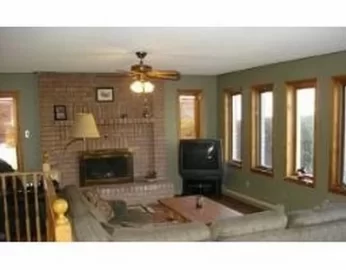

The first pic is the family room with the existing fireplace.

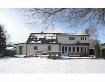

The second pic is the the back of the house, you can see the addition with the chimney on the right

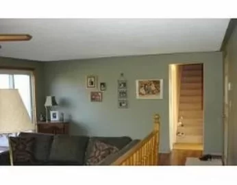

Third shows the the path the heat would have to go to get to the rest of the house. Out and to the left is the kitchen, and you can see the narrow staircase going up to the upstair bedrooms. at the top of the stairs are the bedrooms on the original part of the house and to get to the master bedroom on the addition you have to turn right at the top of the stairs and walk down a long narrow hall.
I don't know how easily the heat will flow around a house like this and was wondering if you guys have any sugestion as to the best way to warm the house without using the baseboard heat of having the furnace on too much.

Welcome braeden. Your concern about the layout being poor for heat distribution are correct. Multiple stoves or a central wood boiler or furnace may be an option to consider for the future. What is the sq ftg of the house. What kind of windows? How well insulated? Is there a basement?
While the fireplace may seem like the obvious place to put an insert, an exterior chimney usually performs poorly and often can have creosote issues. An insert installed there will need an insulated liner. It will be a challenge to heat the whole house given that it is at one end of the house, but it will help a lot. When you move in, you might want to examine the attic to see if there was an original chimney chase, perhaps coming up from the kitchen. Homes that were exclusively heated with wood usually have their chimney centrally located. A somewhat open floorplan assists the heat distribution.

I'd just get a cord of less seasoned wood (not green) to mix in with it. Not too much though. That exterior chimney is likely a creosote producer and doesn't need more fuel (green wood = creosote). Be sure to have the chimney inspected before burning.
Running it as a fireplace will likely be a net heating loss. That is more heat heading out of the room as the fire starts and dies down, then net gain. An insert with an insulated liner will help reverse that situation.

Regarding getting the heat up your stairs, where are the stairs in relationship to the fireplace? It looks like you have an open floor plan. However, if the room is long and the stairs are on the other end of the room you will definitely want an insert with a blower. Also, a ceiling fan in the hall at the top of the stairs might help draw the heat up.
