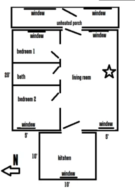

    Here is an attachment of layout of the house. The star is where I wanna put the stove. The porch will be unheated, so that makes the heated are 500 sq ft.

    Oh I forgot to draw a backdoor. It's on the south side (right side) of the kitchen.

    I sort of like the unheated porch. You could us it as part of the main living area if your stove is over heating the main room. That may not be the most logical or efficient approach for your decision making process.
    If the porch walls are insulated and it has a quality door you could keep the door and windows to the porch open make the porch part of your main living area. If it's a screened porch ..... scratch that suggestion.

    The porch has uninsulated walls, drafty 6x4 and 4x4 foot wide windows and drafty door with a mail slot in it. I use it as a fridge in the winter. And my van as the freezer! ;) The porch actually has a heat register vent from the furnace there, but it just brings the temperature up a little. Water will still freeze there.

    How big are your rooms ! That is an awful lot of rooms for 500 square feet.

    The bedrooms and kitchen are about 10x10 each and the living room is 10x20.

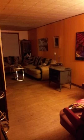

    See the layout in the previous post. The porch is about 7x20. Ceiling are 10', but in the living room there is a suspended ceiling, made out of a 2x4 frame and paper (cardboard like) tiles. I placed an old Huron oven stove where the new one will be to see how it will look. The old stove has some rust holes, not to mention must be inefficient and probably needs tons of clearance. I bought it without knowing anything about stoves.
