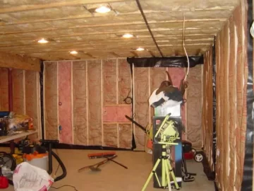

I would love to install it at this location because it would be perfectly positioned where it would heat the basement and some heat could travel up the stairs to warm parts of the first floor. Any opinion and expert advice is much welcomed and appreciated. I have attached a picture of the corner which I want to install the pellet stove. I hope it came through.

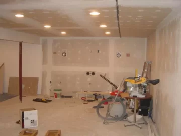

ok I read the post and viewed the pictures. Insulation should have the vapor barier facing the heated side or if unfaced plastic installed wher uf faced is does not have the vapor barrie picture 2 shows that covered up did the inspector pass the vapor barrier issue?
I assume there are other combustion appliances in that basement what provisions have you taken to make up the combustion air requirements they require once the partitioned areas are eliminated from that vollume. I know Englander requires out side air feeds to pellet stoves, but did not read any mention of such

To answer your comment elk I do not have any other combustables in the basement because my heating system is located in the attic leaving me with a 30' X 30' blank canvas for my imagination to run wild with. Also if you look at my pictures posted, I have installed some in wall speakers on the wall with a plasma which will be installed later between them. Do you guys think that the stoves postion will be an issue?
