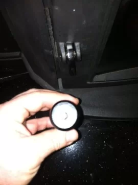

    We've had the HI300 for a couple weeks. Got the oversized surround installed Friday and everything looks great. Ran it all day Saturday without incident. On Sunday, the wife came home and wanted to start a fire. She was struggling to open the door (the latch is very tight) and snapped the handle right off! Looks like the bolt that attaches the handle broke, and half of the bolt is still inside the latch. :( Is this a common problem with these units?
    The dealer was very responsive and is coming out today to repair it.

    Well the dealer came out yesterday afternoon and replaced the whole handle assembly. He said he thought the door was a little tight when they originally installed it, but they were hoping the latch would loosen a little as the gasket got compressed. The new handle opens much easier than the original. I'm happy they were so responsive. Guess I'll have to wait til Fall to get it running again. 70+ degrees today!

    Wow. Just had the same thing happen to me this week :( Had an enamel Hi300 with oversized surround with blower put in a couple of weeks ago. We got about 5 fires out of it before the handle broke off in my wife's hand.
    I wasn't home when it was installed, but the installer told my wife it would "loosen up" over time. It actually seemed to be doing just the opposite.
    They are coming out today or Monday to fix it.
    The service manager commented that that have had this happen more than once recently and are contacting Regency to see if they changed anything.

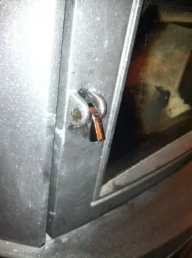

    HI300 installed new last year (Fall 2015). My wife broke the handle about a month ago. The door is "locked" shut and I can't get it open,

    If it was just a matter of the handle being broken I would be have been using with vice grips to open, but the door is virtually locked shut. I've had a 5lb hammer with wood block on it attempting to bang it open with no luck. The pipe leverage option might work, but I do fear additional force might mess lead to other damage. i.e. bending the latch catch mechanism on the interior
    I'm thinking I need to somehow pop out the pin holding the latch to the door to loosen things up. That piece needs to be replaced regardless. I attempted that but couldn't get the pin to come out.

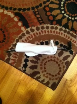

    After leaving a message for the installer hoping to get an estimate on cost for replacement I made one more last ditch effort to get the door open. I went with the leverage approach.
    Using a small crowbar with a towel wrapped around it to protect the stove I gave it a hefty pull.
    Attempt #1 - The door didn't open and the I ended up pulling the stove out about 2". That made me a little nervous. I pushed the stove back into place.
    Attempt #2 - POP! The door opened!
    I'm back in the burning business!

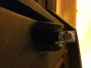

    The latch catches just enough to keep the door semi-securely shut. I don't want to push it in b/c I'm afraid it will get "locked" again. It's most likely not a fully sealed door, but it will do for now until I figure out the latch replacement and adjustment situation. I have a feeling it's a combo of latch quality and the washer adjustments. I'll need to play with it.

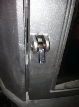

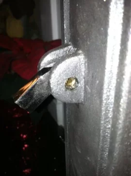

    The only way to remove the latch is with the little pin as seen in the pic. If anyone has experience with that let me know. I think I need a tap the size fo the pin to hammer out.

    You need a punch all the size of the pin cause the pin is hollow. I would drill that sucka out and retap a threaded rod in it.
