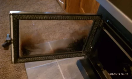

    We decided to throw some wood on, ignorant non-cat owners we are, so I put three splits of alder on the kindling coals. Each split was a normal 3-5" split from the heritage stash. Let the splits get flamed up for a few minutes, stat on 3, cat in active range, and engaged cat, turned down to 2 for a 5 minutes, and then to 1 at 7pm with no flames. The stove top went to 550, cat to top of active range, and then stayed there. A bit hotter than I wanted but I don't know what to expect so..... I went to bed when house temps hit 79 at 10:30. Next morning at 7 am I had about 30% of the wood still burning and cat still active. What the heck? Alien stuff. I pushed the wood chunks together, set the stat to 2 and went to work. Just ashes when I returned from work at 6.
    The picture of the window was from today after the fire cooled down. I really should have let the fire burn in for longer but was trying to keep the stove cool.
    Once the weather cools off and you can burn hotter the glass stays pretty clean, not non cat clean by any stretch but you'll get over it when you see how much easier things will now be.
