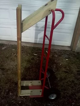

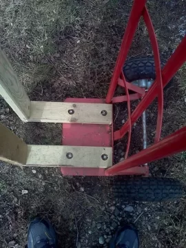

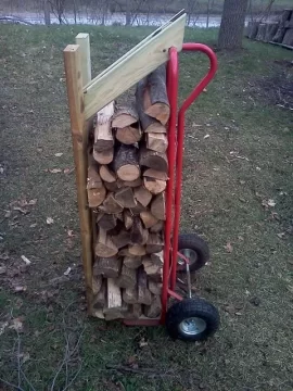

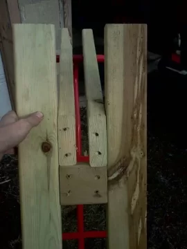

    I thought I would show you guys my firewood cart I made a few years ago so others can do this or give me ideas on how to make it better. It is a firewood cart made from a couple of treated 2*4's and a 20 dollar TSC dolly. Believe it or not it isn't made of pallets :lol:
    Merry Christmas
    Pete

    Looks like a nice tool to move wood around... Once you get snow, slap some ski's on that!

    Haha ya I use it to go up steps into my mudroom in the winter maybe I can attach a winch to it and skies then pull it up the steps this year :lol:
    That would be so much easier.
    Merry Christmas
    Pete

    I use a very similar set up, except I built a box about that size that I use a strap to hold onto the dolly. I did this so that I can still use the dolly to move large rounds in the yard.

    I was given one of those as a gift, but wheels too small and tipsy when loaded- so it serves to hold kindlin.

    Heck, I'm nominating you for a Red-Green award: if the women don't find you handsome, at least they find you handy. My only suggestion (since you asked) would be to make the angled pieces at the top swivel for ease of loading. If you put a cross-piece between them, you could just grab that and open it in one move.
    This is cuter than a speckled puppy-dog in a red wagon under a Christmas tree, and you ought to put it in your sig line, don'tcha think?
    I use a cargo sled (summer and winter) for hauling wood around. I pull it right into the sun-room and unload it on the rack. However, it is not nearly as cool as this.

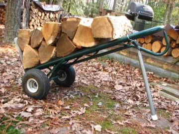

    [quote author="Pete1983" date="1324707838"]I thought I would show you guys my firewood cart I made a few years ago so others can do this or give me ideas on how to make it better. It is a firewood cart made from a couple of treated 2*4's and a 20 dollar TSC dolly. Believe it or not it isn't made of pallets)

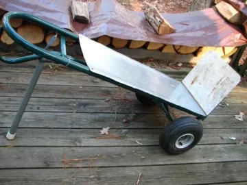

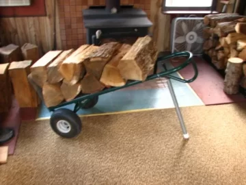

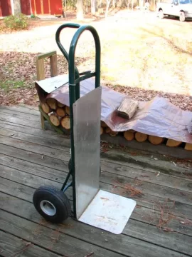

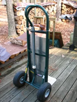

    Nice job Pete. I made one from a dolly too. I put a longer bottom plate on and covered the back too keep dirt from falling on the floor when i wheel it into the house. It has a leg on the back that only swivels far enough to support it while loading & unloading.

    Very nice caz looks good I might copy it.

    How did you anchor the sheet metal caz?
    Thanks
    Pete
  18. Cazimere
    Cazimere
    Member 2.
    Oct 29, 2007
    226
    2
    Delmarva
    I used pop rivets on the bottom plate & self drilling pan head screws on the larger back plate.
