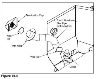

I had a MT Vernon insert installed back in May. Like others, I was told by my dealer that OAKs were a waste of money. After reading comments from all you wise pellet stove owners, I tend to side with you that they keep your home warmer. I think I would like to make my own OAK and was wondering what you folks think about this plan.
My insert is located in an enclosed inside pocket wall. (There was originally a propane fireplace in its place). The pocket is a triangular shaped wall enclosure, not open to any other area in the house. My thought was to install a dryer vent outside the house, use flexible dryer vent hose (aluminum) and run it through the floor, into the pocket where the insert is installed. It would not physically attach to the stove; rather it would supply cold air (along with some heated inside air) into the pocket, which would then be sucked into the MT Vernon. I have read that some OAKs have a hole cut in them to allow some inside air to mix with the cold air; this is what I'm thinking my setup would mimic.
Please give me any and all advise and opinions on this this hair-brained Summer project!
