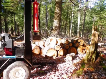

    I get out my maul pictured below, an American CLS Vertical/Horizontal 24 ton wood splitter.
    zap

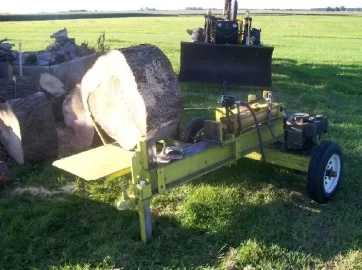

    Piece of cake Dennis. ;-)
