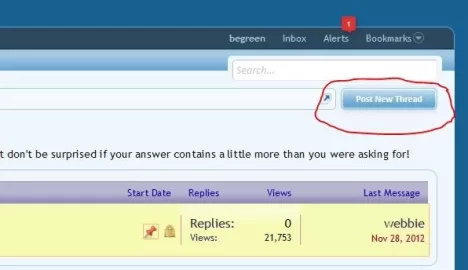

I think it's best in this case to start a new thread. Your stove is different.
Thanks begreen. I searched for about 10 to 15 minutes and couldn't find how to start a new thread. I found how to start a conversation. I did find a pretty good site on a cast iron restoration. He mentions stove cement. He mentioned that he applied the cement to the joints and bolted it down before it dried. http://gingercreekstoves.wordpress.com/2011/04/22/a-stove-restoration-in-progress-king-arizona/
Still would like some more advice from others that have used the stove cement when reassembling their stove. Seems like the part, not to screw up, since the seal of the stove counts on it. The stove cement itself might have some decent directions. Really enjoying the stove restoration. Should get my stove pieces from the sandblaster in a few days:). Remodeling my house and I have no heat right now. End of August and beginning of this month, have been cold so far in Centralia,Wa. The geese know what's up.Chopped up more than a cord of dry maple. Hoping to add upon the stack by the end of this week. I will do another search for the new thread link.
Go to this forum's home page. The button is in the upper right corner.
