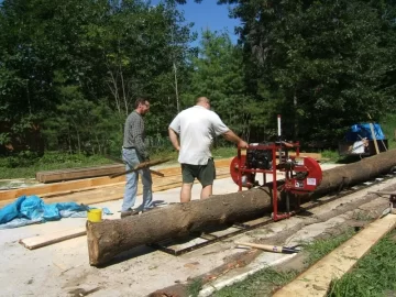

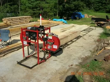

Peter SWNH said:Yea, I have one. Great little machine...for personal use. No way you are going to get PRODUCTION out of it. Needs a stable FLAT base to cut straight, though (think concrete slab or deck/platform). I used mine to cut most of the wood for a friend's 28x40 timber frame barn years ago. My friend bought enough extra track to cut 20ft beams.

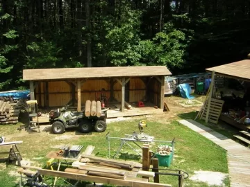

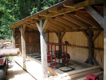

I just used it last week to resaw some extra beams into siding and mill up a few straight small logs (too good for firewood) for my new equipment shed (3rd and 4th pic below). Bands are $20 each new and resharpening costs about $7 each in lots of 10 (including shipping).

Peter SWNH what model is that and how long have you had it? Nice setup.

It's the Oscar 118. Bought it in 2005.

Nice, for the base would crushed stone with 4x4's leveled up work for putting the track on?

You could just build a small deck level is the key and you want it to be permanent.

Yes, that would work. I originally set it up on the lawn (before my friend had the barn foundation poured) and it was flexing enough to affect the cut. Think railroad bed. Other than blades, the only repair/maintenance I've had to do was replace the drive belt and change the oil. The B&S engine runs like a Honda (so far).
If you have the log handling capability, I would suggest you consider going bigger (Oscar 121+). Mine is rated for 18", but it'll ONLY do that size if the log is ruler-straight. Any crook or bend will reduce the max size significantly.
