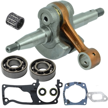

Not a big specialist , but it looks like crank shift broke on my favorite toy. I don’t know the age of the saw. Got it on Craigslist and was using for three years . Cut about 30 cords with it . Paid $150 , which was a steal.
So, is this a crankshaft assembly replacement?
Is it even worth it.? Part run about 300 online. And I can see it's not an easy task.

Its junk, send it to me. Lol. Anything is fixable as long as the block is good. It just depends on how much you want to spend. It's not that hard to put a crank in a saw and rebuild it. It just takes time.

Check out hlsupply.com for parts. That's who I use for husqvarna parts. If you take the saw to a dealer, they will say its junk and to buy a new one. If you are a do it yourselfer, it would be a fun project. You really get to know a saw when build one.

It is an easy job to change the crank if you have mechanical skillzz.
If not buy another saw the same and use the broke one for parts.
Or sell the broke saw and replace it with a saw you want to try.
I’d say you got your money’s worth out of it. A fun project it could be, but time is worth something. I’d vote for a new or used saw and keep for when you want a project (or junk it sell it).

It’s $300 on HLS. Found this on eBay
(broken link removed to https://www.ebay.com/itm/Husqvarna-357XP-Chainsaw-Crankshaft-537219201-/153500017898?mkcid=16&mkevt=1&_trksid=p2349624.m46890.l49286&mkrid=711-127632-2357-0)
Never done work like this . The most I did was changing or cleaning carburettors.
May be I’ll buy the used part and try it in a winter

OEM is $300, but aftermarket is 70
Or should i get used one for the same price?
(broken link removed to https://www.ebay.com/itm/153500017898?epid=13011509615&hash=item23bd5064ea:g:eTUAAOSwi5Vc5v3H)
300$ is about half way to brand new 550 with a warranty. Aftermarket would be my choice.
