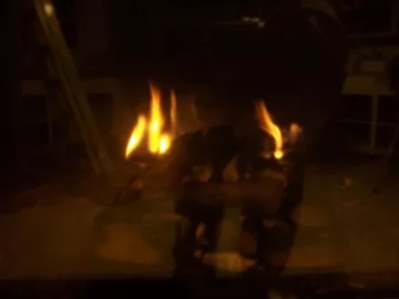

    I guess every one is right about the height of the chimney, its 33* outside I have some kindling and two pieces of smoldering ECO bricks from this morning it looks like it is going pretty good. never mind it has died down in 5 minutes. The first pic is with the door ajar. The Second pic is with the door latched. The last pic is after 5 minutes. It is doing better then today. how good do the ECO brick burn?

    thanks for the PDF bro, though the manual wasnt all that informative (most arent) for what i was looking for.
    as for the issue in general, yeah i think its flue related as well though the 14 ft stack i would think would pull the stove if he's got the bypass open. what im concerned with is that we may have a different part of the roof not necessarily next to the chimney which could be causing his issue. he had in a different thread talked about how the stove would burn one day not the next, and he had mentioned "the closest peak" in a post , im curious if there is another higher peak which even if several ft away can cause difficulty
