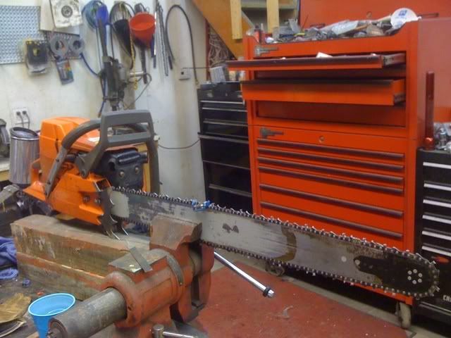

    This is my "in-shop" setup for using it.This is my 394 with a 32" bar. I use a paint pen to mark a tooth as starting point reference. I can crank this one out in about 15 minutes.

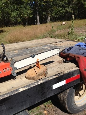

    My in field setup. 7900 with 24" bar and I was getting it done in 5 min per side.
    [​IMG]
    Really no reason to have a dull chain in the field any more when you can touch it up quickly.
