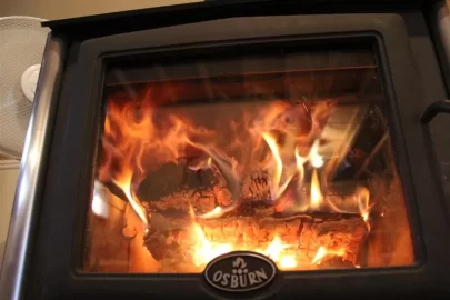

Some of you know that last weekend I cleaned out my chimney with a sooteater. I think I was able to get about 1 gallon of dry fluffy stuff from my stack. My stack is a little over 18 feet tall + the T.
I was disapointed..I thought I would get less. I made a fire this morning and tried things a little different. I let my box temp rise longer and my stack temp rise longer as well before turning down the primary air. I think it made a huge difference. My stack temps never reach more than 500 (unless I leave the bypass open too long) and normally cruise at 400 for the first couple of hours. Today my stove top temp was about 500 before I turned down the primary air and the stack was 500 (I have checked the accuracy of my stove top thermometer before but not my stack).
I took a picture of what I had going about 30 mins after I turned down my primary air. How does it look to you guys??
Thanks in advance!
