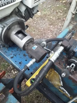

Identify this splitter pump?
gzecc Posted By gzecc, Oct 27, 2012 at 10:31 PM
  1. gzecc
    gzecc
    Sep 24, 2008
    4,468
    871
    NNJ
    The ID tag is damaged. Can anyone tell me what it is?
  2. triptester
    triptester
    Feeling the Heat 2.
    Aug 25, 2006
    307
    50
    S.E.Wisconsin
    The pump is a Barnes/Haldex 11 gpm 2-stage pump which is sold under many different brand names.
