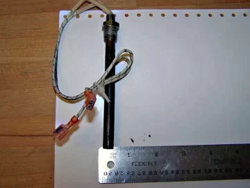

    Ok, here it is...
    G 06 24
    HDC16484
    120V 300w
    U.S.A. WOOD DALE
    Will not allow me to attach photo's.
    ERROR Message: Images must not exceed a width of 1200 pixels by 1200 pixels.
    Not sure how to get them to post.

    email the pic to me and I'll post it. I need length and diameter pls. I'm thinking it's Grainger part# 4NJG6, 3/8" x 5" 300w 120v, $23.05

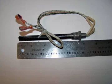

    Here are the pics...
    Not only am I getting help with the stove, but can manipulate pictures now!
    Thanks

    Just looked at the grainger site, looks similar except for the threaded end.
    I looked at my ignitor, does not look like I can remove the threaded piece?
    Seems like it's 1 piece.
    Thanks
