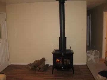

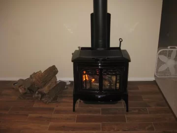

    IMG_7035.JPG Well, after a week of running the Leyden non-stop, I am very pleased! It's very controllable, easy to operate, and gets 8-10 hour burns very easily. I have experienced none of the issues I read about online that others experienced. I hope it continues to run as it should. I'm giving it a rest during this warm weather and letting the Webster Oak have a turn. Happy burning to all.

    I was running it with the lows's in the upper 20's, and it had plenty to spare! I hope it does well when it drops too, I think it will. We never added any wood during the day, only ran it at night. I also added a blower on Sunday to, since it has rear combustion, I thought it might move some very hot air. Even if it lacks a little, I got plenty of back-up stoves.>>

    Webby, don't forget the trick of blowing cool air into the stove room rather than trying to move the hot air. It works!

    Notice the fan? It's blowing toward the stove. It works very well! We've heated with only wood for 7 years now, and moving the cold air toward the stove has been the best tip yet, i think! We don't have any central heating, so moving the air is key for us.

    Forgive me if I'm mistaken, and I'm certainly not calling into question your sweep creds, but are you assuring proper clearances there? Looks like it's sitting on hardwood, too.

    I'm glad you noticed! It's ceramic tile, I wanted tile that looked like wood flooring and I found it! It also exceeds the clearance to the unprotected wall.

    On the Leyden, the CTC is 11" to the collar with single wall and a pipe heat shield and 14" with double wall. I used Dura-vent DVL (free because of the small dent) and used a pipe shield to protect the flue collar.

    Tricky on the tile! I see the DVL shield, now. Nice stove, btw.
