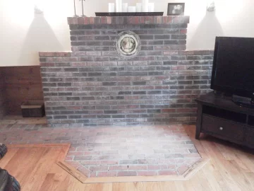

    Thanks for all the input! i think all of you have opened my eyes a bit. Here's my info
    The house is 2200sq Ft, 1984 build, 2 story colonial, faces south, existing stove hearth on west wall, north side of house.
    stove is will be free standing. replacing a removed Vermont casting wood stove.
    The stove will not be use as the primary heat source. I have a natural gas furnace in the basement. but would consider using the stove as the primary source.
    The chimney liner is 7inch ID and has a few cracked tiles. Chimney is approx. 20 feet up from the wall inlet.
    Here's the void in the living room that needs to be filled....
    Thanks again everyone.

    IMO, any of the stoves that have the same look as the Leyden,Empress, etc will look great in that spot.
    As mentioned above, keep the stove on the big side......you might be surprised at how much you like having it running and heating the house.....it's just a very cozy heat.

    Looks like a great spot for an Enviro M55 Cast. I'm heating 2,200 sq/ft with an M55 insert, used 4 tons of pellets last year for the whole heating season.
    I would recommend adding a stainless liner to the flue before installing the pellet stove. Just makes everything safer and much easier to clean.

    Personally I think the XXV or the M55 cast would look sweat there! A nod to the M55 cast as it could fill either roll. I know NG is cheap now, But better to plan ahead JIC the price goes threw the roof. Another reason to stay on the large size. If thats the case the P61/68 or Maxx/ Maxx M are big dogs that are probable "heat the whole deal" units. To be fair there are quite a few big units on the market these days. Price point and looks will be high on the list when choosing the unit too!
