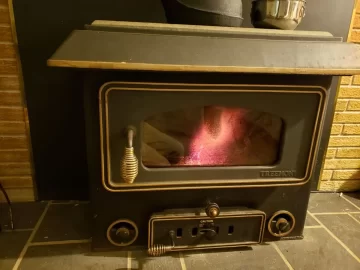

Im new. Trying to know more about my stove
Youbet7
Dec 3, 2019
4
0409frogskin7

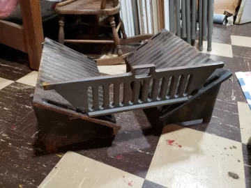

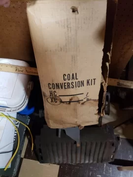

Yep its treemont, I think I would have better chance finding big foot before any info on this stove. Came with the house, works awesome! Came with a coal insert. Hesitant to use the coal but would like to try. Also can I get parts if I need them. Any chance on model or owners manual. Anything would be appreciated. If anyone can help with any info, thank you so much in advance.
How is it installed? Does it have a liner hooked to it running to the top of the chimney
I do not believe it has a liner. Last spring when I cleaned the chimney. All I saw was block. No metal piping. Should it need it? Seems to work fine. Or is it needed for coal?
It is needed to safely use your insert. When you cleaned it did you pull the insert out?
I didnt pull anything. Just used a chimney sweep from the roof top.
Then you only did about 1/4 of the job. Where did the stuff you swept out go?
Yep your right, should have pulled it and clean the top! Thanks you have helped alot!
Your really need to properly install your stove if you want to use it. The way it is now is unsafe
