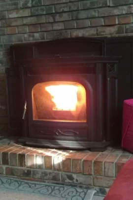

I purchased a Harman Accentra pellet stove insert on craigslist. Looks like new, was just serviced and they had the tech install a new igniter because they had told them that the older ones could crack due to a design flaw or something and if that did happen they would have to pay a service fee again to have them come out or just pay the extra $100 for the part while they were servicing it. It fired right up so we agreed on $2300. He is having it professionally removed and my plan was to pick it up and install it myself. Currently I have a wood stove insert. I have to see what if any liner I have in the chimney. The quote I got is $900 to have it installed and a full liner installed. I am assuming there is no liner so if I do it myself I will have to buy a liner for however much it costs and figure out how to install it. I usually do all this stuff myself, but I came here to get some advice about install and on pellets and such. I am picking up the stove this weekend so hopefully tonight I can start to pull my old insert out.
I am still doing research on here and reading the manual. I know nothing about this stuff but I am not asking to be spoon fed. I see I will also need to get a draft meter, so hopefully I can pick one up cheap. I don’t want to end up spending as $900 to install it myself...but I am very excited about this as I won’t have to move and stack wood and get from outside all winter and get dirt all over the house (which is very important as I have a 1 year old now). Plus the fans on wood insert that is in there now are broken so I have been using two 4” desk fans and the air adjustment has been broken so it is in pretty bad shape. I am hoping with the Harman that can heat my whole house, which is probably 1200sqft not included basement (installed on 1st floor (single story house with basement).

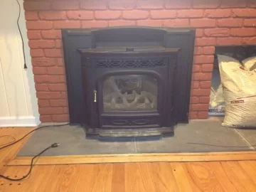

You can vent it like it says in the owners manual. 5' Section of 6 inch pipe through the block off plate with insulation on top of the plate. Full lining is better but not necessary. Worked fine for a season with my Accentra. I have a full liner now because I found the liner for $75. This stuff isn't as scary as people make it. As for plenty of heat. I have 2600 sq ft split that I heat from the family room downstairs. 70* downstairs 68 at the stat upstairs. It gets a little chilly in the two far bedrooms but very do able. You should have NOOO problem with the upper living level . Downstairs may be a challenge. I have a draft meter. Buy or borrow. you pay the shipping??

Picked stove up and got it into my garage. Will be installing once I get liner.
