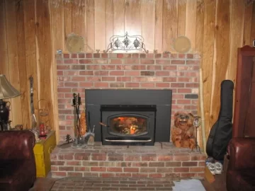

The stove installed is an Avalon Olympic. I will take some pic's today at some time and post them.

Here is a picture.
  • [Hearth.com] Install on Wednesday?
Looking good. Usually block off plates are custom made because the have to be site fitted. But all it takes is some sheetmetal. Did you read the wiki article on making one? Also search for iceman's recent installation for some good visuals.
I checked with the dealer and installer and they only install the block off plate if you ar going to end the pipe at the clay liner of the chimney (also in the instuction manual) but since I ran pipe from stove to top of chimney it is not required.
If there is some reaseon I should add it please let me know why and I will install one. If it meens more heat in the house or for sfafty reasons it is a done deal.

Yep, both.
