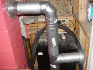

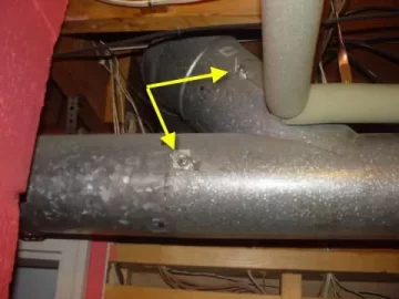

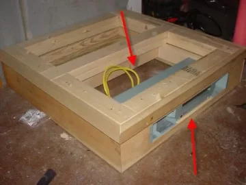

Well, I installed it myself so this is what it cost.
$600 for the raised hearth and tiled back including 220v 900 watt electric kickspace heater and rope lights with tiled mantle.
$250 for 4" pellet pipe to connect into my chimney and 2" Outside fresh air flex pipe and connectors. See pics below

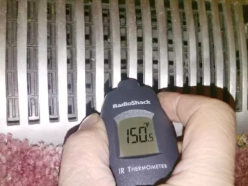

$250 for duct work and registers to distribute the heat upstairs from the basement.
So about $1100 for parts but if I paid someone else to do this work, then I could not afford it!!
See 150 Degree heat coming out of register into the Kitchen and Living room!!
