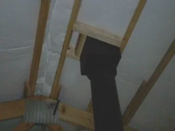

    I went through the roof, near the peak.....it was the easiest

    Nice install! Hope you're gonna add a storm collar to that system...

    lol..yep. I did this a couple of years ago. In progress photo. All appropriate places sealed with silicone too.
