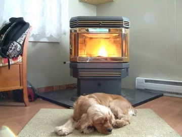

    i think you'll be fine with it where it is,our laws here are pretty strict for placement in order to keep fire insurance on your house.As you can see by mine,i have a close window on each side,but the exhaust pipe was 24 inches from window,so it passed all requirements just fine,Dog gets more enjoyment from the stove then us i think,lol...
